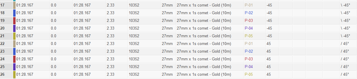

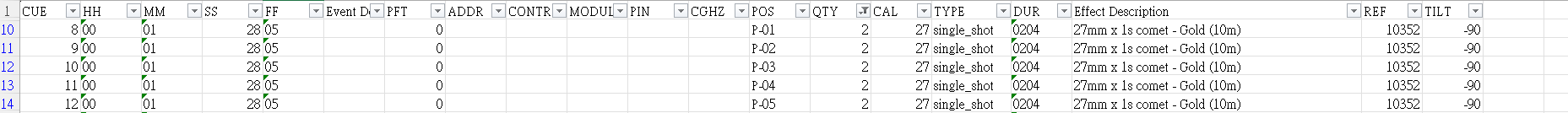

    I export the script to csv. But the quantity and tilt angle are different from my finale script; only a few cues have this problem.
    Hi pyro52634673, I’m happy to help.
    It appears your show has not been addressed. Please try assigning firing system addresses by going to Addressing > Address show.
    If this does not resolve the issue, please send your show (.fin) file to support@finale3d.com. In your email, please also tell me which menu option you are using to export your script and give me an example of a specific line of script that does not export properly.
