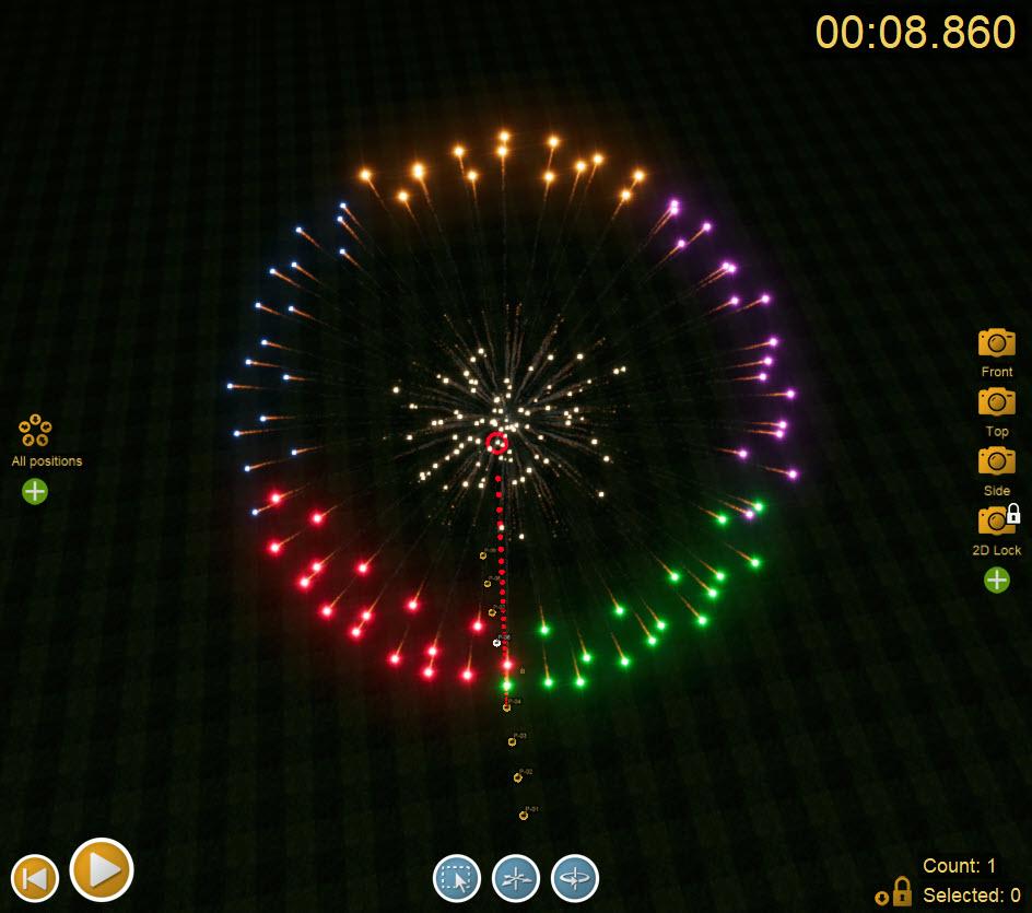

    The effect in your video is fairly complex, especially due to the color changes. To create this effect, it’s easiest to create five separate JSON break patterns, one for each 1/5th of the ring or “band” pattern. Creating the segments as separate break patterns allows you to individually control the color changes for each segment.
    Here is a link you can use to download a Finale 3D show file containing an effect like the one in your video: https://finale3d.com/wp-content/uploads/2026/04/6in-Five-Segment-Color-Changing-Band-Shell.fin
    You can open this show in Finale 3D and open the effect in the effect editor to examine its structure.

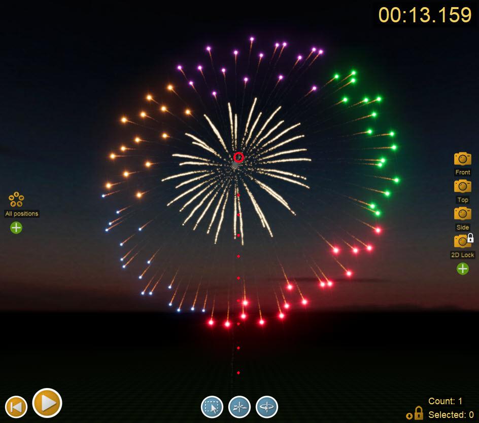

    Here’s another example of a five-segmented band shell. This one has a gold to white strobe double-stacked ring pistil.
    Get the effect on Finale DB here: https://finaledb.com/product/pfuso2dzl0o53nd
