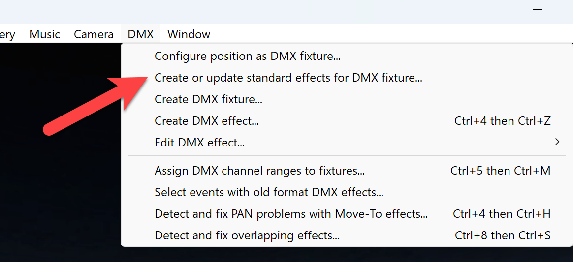

    Hi,
    I am unable to find the Explo Waveflamer X2 cues in the Generic library anymore. These cues used to be available, but they seem to have been removed or are no longer appearing in the list.
    Is this a known issue, or have the Explo cues been intentionally deleted/moved to a different section?
    Thanks in advance for your help!
    In the 2026.03.19 full release version of Finale 3D, the Explo X2 Waver Flamer effects (and all other DMX effects) have been removed from the Generic Effects collection. Supplier catalogs containing DMX effects are also obsolete. All new and improved DMX effects, including the upgraded Explo X2 Waver Flamer effects are accessible by navigating to DMX > Create or update standard effects for DMX fixture (see screenshot below). The Explo X2 Waver Flamer effects are generated this way both for use with DMX-capable firing systems or the Explo ignition system.

    Thanks Drew.
