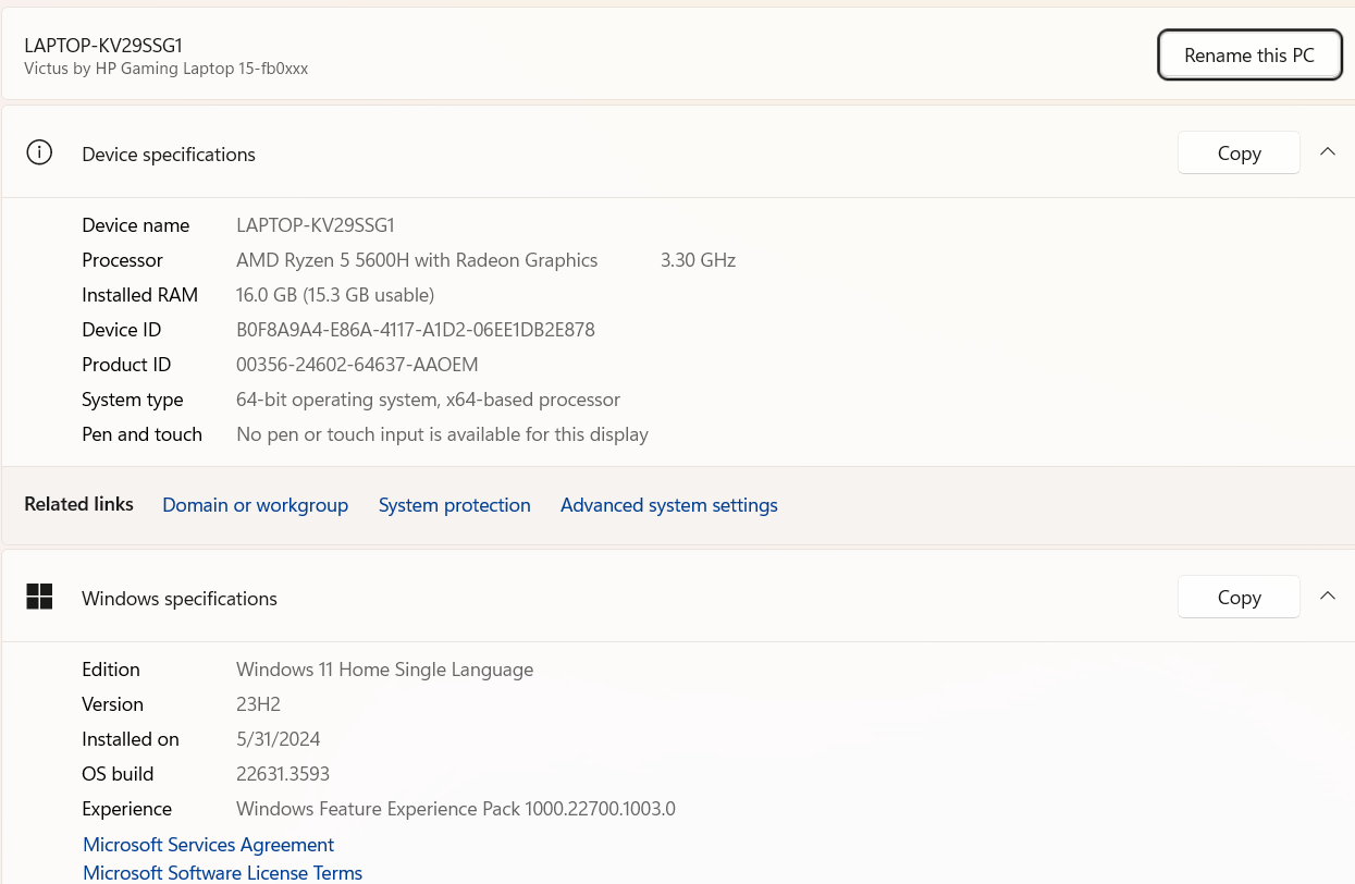

    Hello, does anyone have problem opening Finale 3D? I used to be able to open it but now nothing happens when i click on it. Tried installing and uninstalling the latest version won’t work, it does run fine on the other PC we have though.
    Here is the info of the pc.
    pc info
    Thanks!
    This could be an issue with your graphics card (GPU). The info in your screenshots are very helpful but they don’t list your graphics card. Can you tell us what graphics card is in your computer? If you’re not sure, you can search for Device Manager in the Windows Start menu. Your graphics card will be listed in the Display adapters section of the Device Manager.

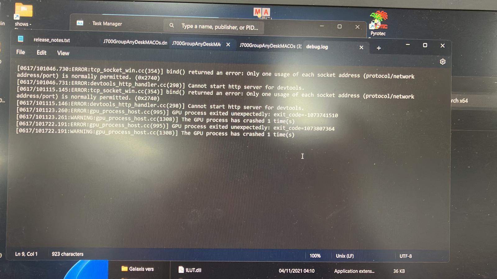

    I have had the same issue today! Been running fine on the same laptop up until today. Tried uninstalling and reinstalling, but it never opens. IT department said this is all they could find that was showing a sign of error.

    2) I was using May 2024, this doesn’t open at all. If I try Sept 24, the ‘One Minute Please’ window opens, then it goes in to ‘not responding’
    The graphics card is an AMD Radeon 550X.
