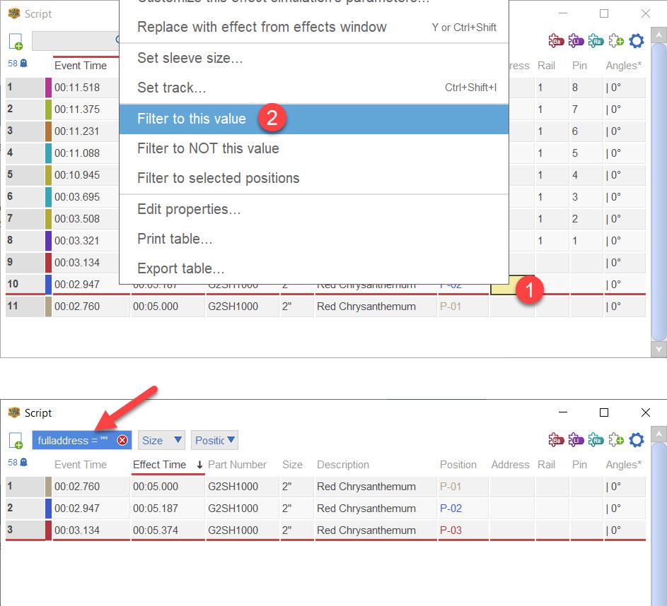

    Great suggestions, Dirk Enders – PyroOffice! Assen, another option for you would be to use the search box to filter your script to only show lines with a blank ‘Address’, ‘Rail’, or ‘Pin’. The easiest way to do this is to right click on a cell that’s blank and choose ‘Filter to this value’. The great thing about the right click menu option is that it automatically adds the appropriate expression to the search box. For example, if you right click on a blank cell in the Address column and choose ‘Filter to this value’, fulladdress = “” is automatically entered into the search box. If you don’t have the Address column visible, you can unhide it from the blue gear ⚙️ menu.
