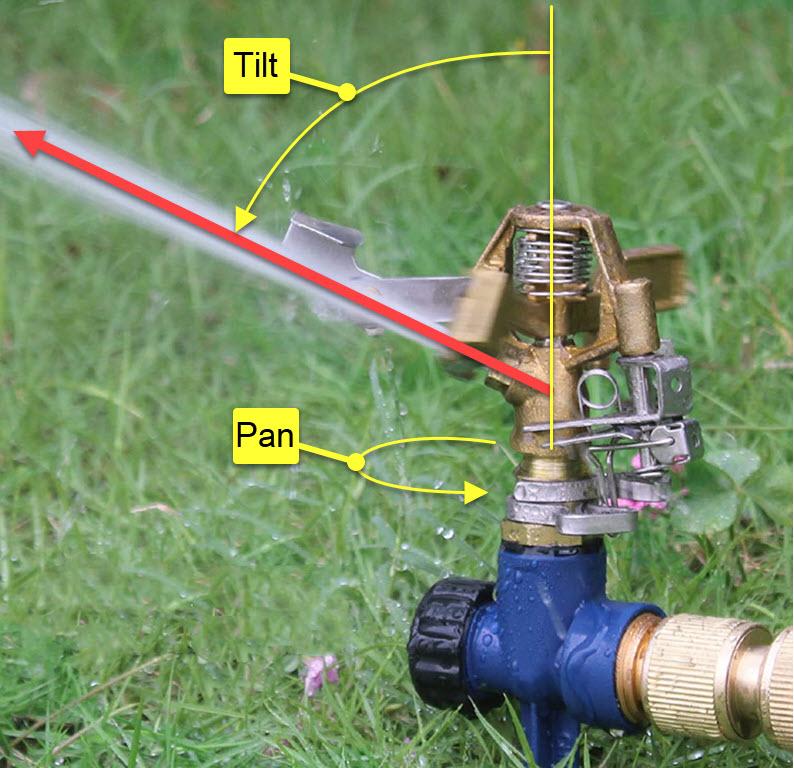

    Another possibility is that you inadvertently changed the “Pan” angle for one or more of your effects. The “Tilt” angle is actually the angle from vertical. The “Pan” angle is the angle around the vertical axis. Check out the impact lawn sprinkler in the photo below. The jet of water is tiled to spray water out at an angle, and the sprinkler pans around to cover an area of lawn. An impact sprinkler’s “Tilt” angle is fixed, and the “Pan” angle is changing as the sprinkler swivels around.
