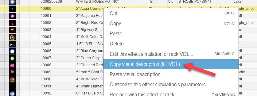

    P.S We added a new feature to the effect window based on your feedback. You can right-click on an effect and select ‘Copy visual description (full VDL)’. This copies all the effect parameters to your clipboard so you can paste it into an email or here on the forum to share with other users. I used this feature to share the full cake VDL above 🙂
