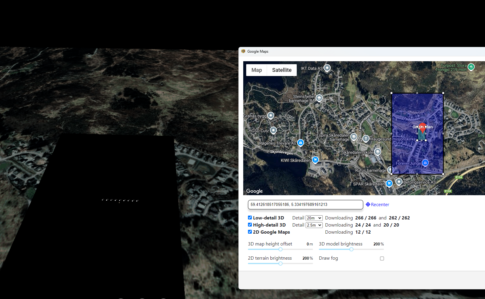

    Hi,
    We have trouble using 3D maps. 2D works fine, but 3D shows only black.

    I have been encountering the same issue with any 3d maps.  Black box on the map with both high and low detail 3d.  2d Google maps works.  I’ve tried everything within Finale3D to try to correct it.  Restarting, new show, reinstalling finale3d and still the same result.
    Thanks for the report. We are experiencing the same behavior on our end. We aren’t sure if the problem is Google or Finale; we are investigating the issue.
    I’m happy to report that we just published a new BETA release of Finale 3D (2025.06.14-7563c981a) that resolves the 3D Google Maps issue. It turned out that Google made a change on their end that required us to do some modifications to Finale 3D.

    It works now 🙂 Thanks!
