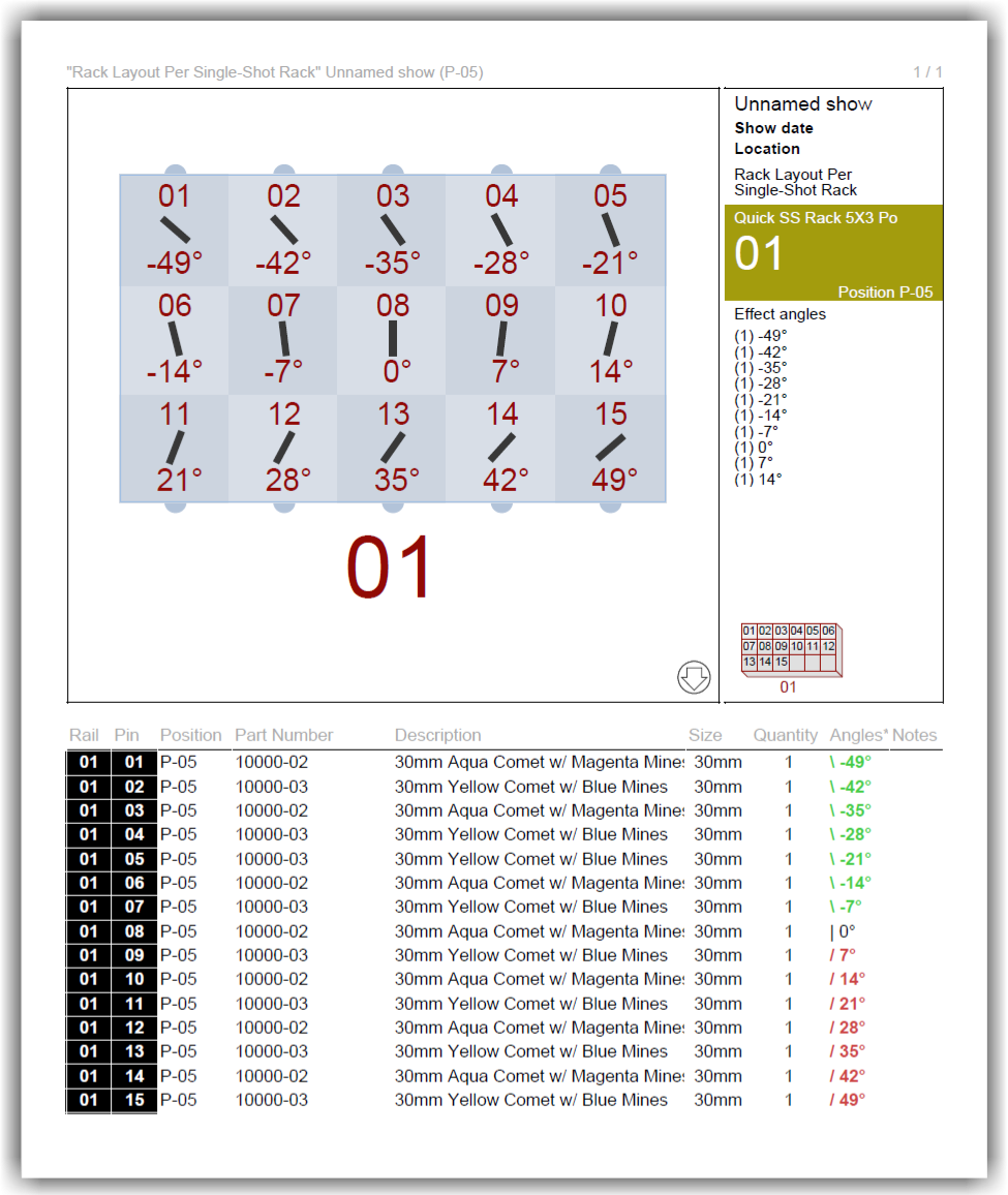

    Finale 3D Hobbyist is able to calculate the number of racks needed for a show based on the types of effects, angles, etc. This is true for all kinds of effects and racks, including multi-load CraigCo racks. However, the Hobbyist version doesn’t provide rack layout diagrams and consequently, is not able to optimize the addressing of a show based on the layout of the racks.
    Finale 3D Pro calculates rack quantities, provides custom visual rack layouts, optimizes addresses based on the rack layout, and provides printed diagrams, like the brand new hybrid rack diagram + script report shown below.
