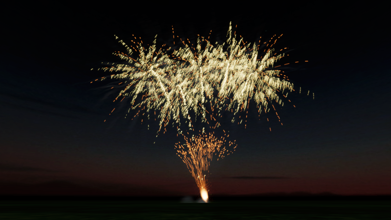

    The photos below show the timeline and the result of the simulation, which is the correct and intended effect of a low-level mine effect under the primary aerial effect.
    Photo of mine effect in cake slice before combining into full cake.

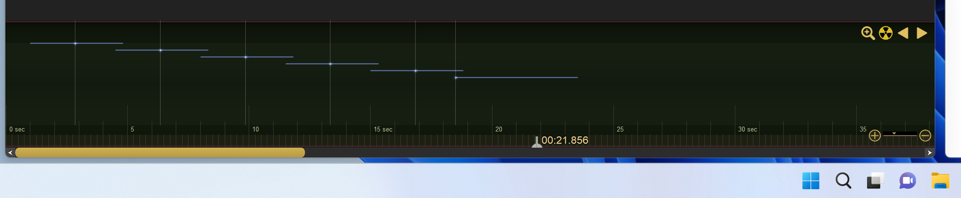

    Timeline of separated cake.

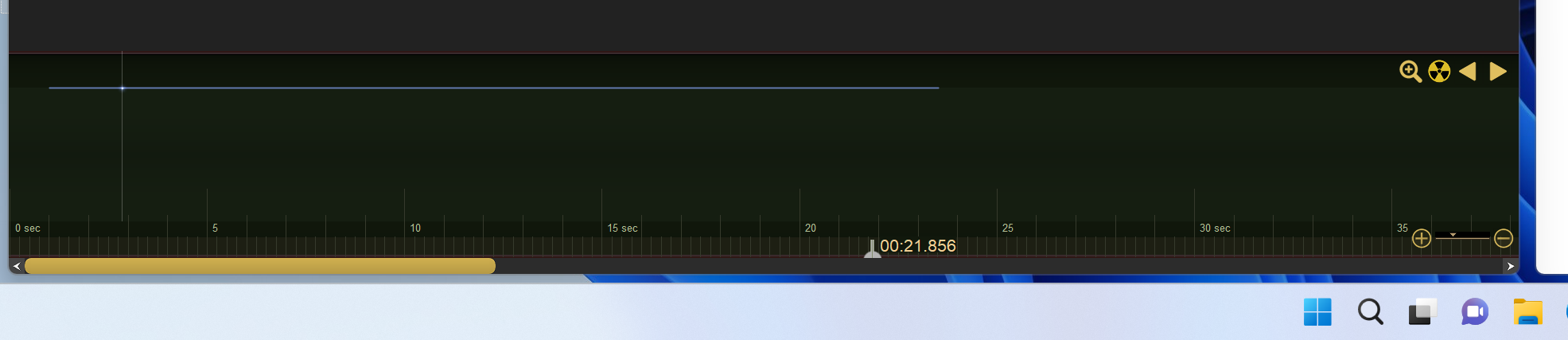

    However, when I combine the 6 rows into a single cake (making a cake out of cake slices), the velocity of the stars in the mine effect increases dramatically, propelling the mines to the same height as the primary aerial effect.
    You can compare the above and below images.
    I think the problem has to do with the fact that I made a cake within a cake (a “cakeception” if you will). However, there’s no more effective way to organize a cake than what I’ve done here. Tubes are arranged into rows, rows are organized into a cake. This is the most common method for organizing and communicating a cake design to the factory.
