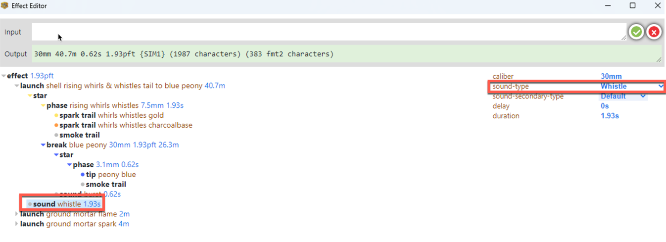

    Hi Barehm,
    for the first VDL you can try the following effect editor setting:Effect Editor settings
    Hope this helps
    Dirk
    Hi Brett,
    Thanks for the additional info, I was able to reproduce both bugs. The key to reproducing the height issue was knowing that you were creating a cake using effects that had been customized in the effect editor. The bug seems to only apply to custom effects, not VDL effects. For the missing whistle sound bug, the VDL you provided was just what I needed.
    Dirk Enders – PyroOffice is absolutely right, you can use the effect editor to add missing whistle sounds. Although, that shouldn’t be necessary, the fact that the sound is missing by default is definitely a bug.

    Hi Brett, with Dirk’s suggestion, you can add sound effects at any level of the tree. You don’t have to choose between a rising whistle sound, a break sound, or another sound effect for the stars after the break.

    Regarding your suggestion to add nodes anywhere, do I need to dump this out to a text file first?  When I click the action drop down next to each node, I’m very limited in which ones allow me to put in a blank sound node.  For example, I can add one on a ‘break’ node, but not on a ‘star’ node. When I build this VDL:
    1.75″ Gold Peony w/ Time Rain w/ Tiger Tail Single Shot
    Then I can see a sound node under ‘star’, but I can’t add one manually (or add one in another effect being edited in the effect editor). It does certainly work to change the effect of an existing sound node.
