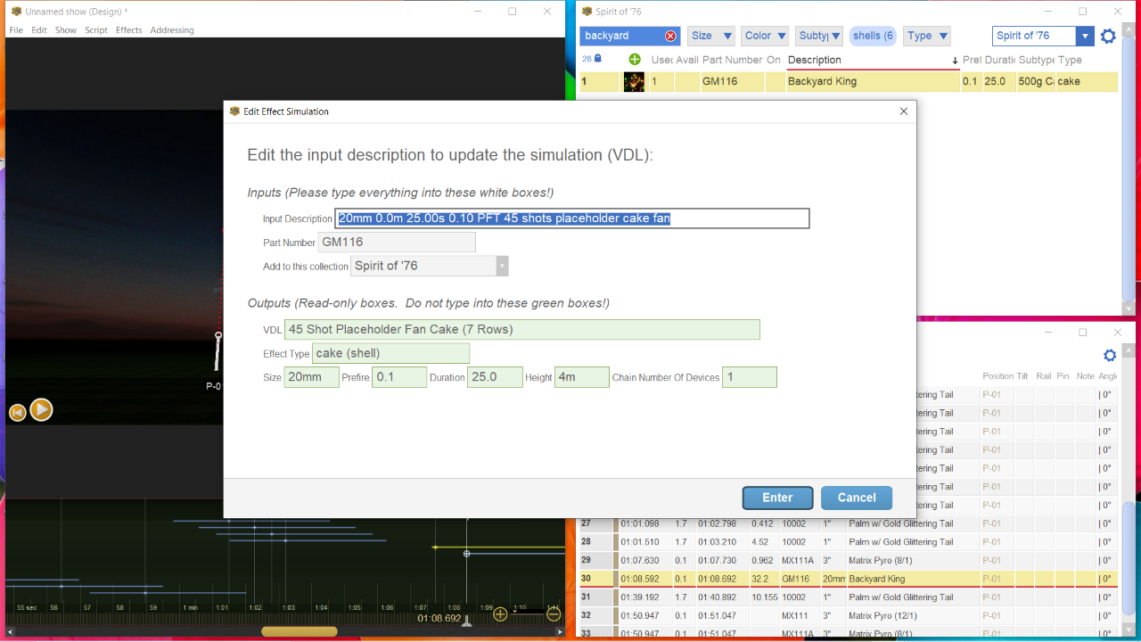

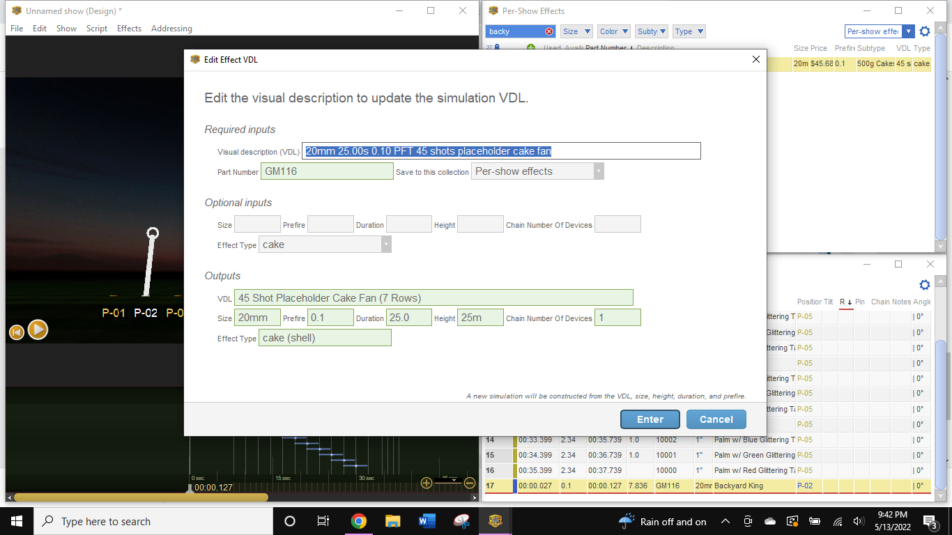

    I’m not sure if this is the right place to put this question or not but it is “kinda, sorta” a cake question.  My dad and I are working on our 4th of July show and as we were adding cakes to our script, we noticed that there are some discrepancies with what we were each seeing (on two separate laptops, each running finale.)  We tested this on two different cakes but I’m adding pictures of “Backyard King” to give an example.  Not all the information matches when it’s the same cake – the height output is different.

    Hi Kristine Ernzen, your screenshots show that your computers are running different versions of Finale 3D. The ‘Edit Effect’ dialog in your second screenshot has a middle section titled, ‘Optional inputs’, this represents a recent “BETA” release of Finale 3D. In contrast, your first screenshot shows an older version of the edit effect dialog, and therefore an older release of Finale 3D. You can check which “Build” you’re running on each computer by going to ‘File > View account details’.
    Normally, I would expect effects to be identical between different software builds, but in this case the BETA version represents the culmination of a large effect improvement project. The only question is, which version is working correctly? If the height is correct in the old version, then we have bug to fix before we do our next build. On the other hand, if you think the newer, BETA version is better, then the solution is to update the computer running the older version to the latest BETA.
    Kristine Ernzen
    Posts: 9
    Location: Waynesboro, Virginia, United States
    Thanks Drew!
    I will have dad update his version and see what happens!
