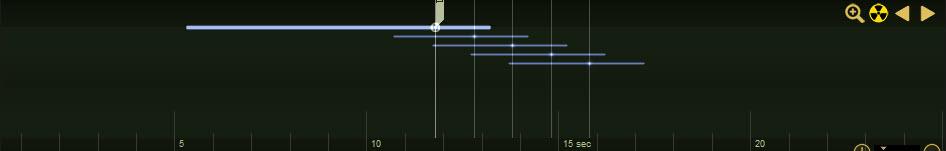

    Hey MikeG, for custom chains (where the shells are loose and you’re fusing/chaining them together when prep your show), the standard workflow is to add the individual shells to the timeline, then go to Script > Chains > Combine as chain.
    The problem is that this workflow doesn’t support a delay before the first shell on the chain. But not to worry, there are workarounds. Here are a couple options for you:
    Option 1) Create a special shell with a delay and use it as the first shell on your chain
    To create an effect, go to Effects > Create effect
    Example full VDL phrase for a 1.75″ Red Peony with a 4.4s external slow burning fuse: 1.75″ 6.50 PFT 2.1 LFT 4.4 DLY Red Peony
    PFT = Prefire = total time from firing system ignition to shell burst
    LFT = Lift Time
    DLY = Delay
    Adjust values as needed but make sure DLY + LFT = PFT.
    Here’s a screenshot showing the special shell, followed by standard shells, arranged on the timeline.  To chain the shells, go to Script > Chains > Combine as chain.

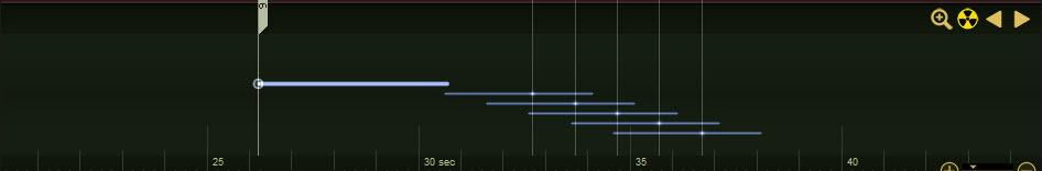

    Option 2) Create a dummy “Delay Fuse” effect and place it before the first shell in your chain
    Example full VDL phrase for a delay fuse effect: 1.75″ 4.4s Dark Ground Flare
    Here’s a screenshot showing the delay fuse effect, followed by standard shells, arranged on the timeline.  To make the final chain, go to Script > Chains > Combine as chain.
