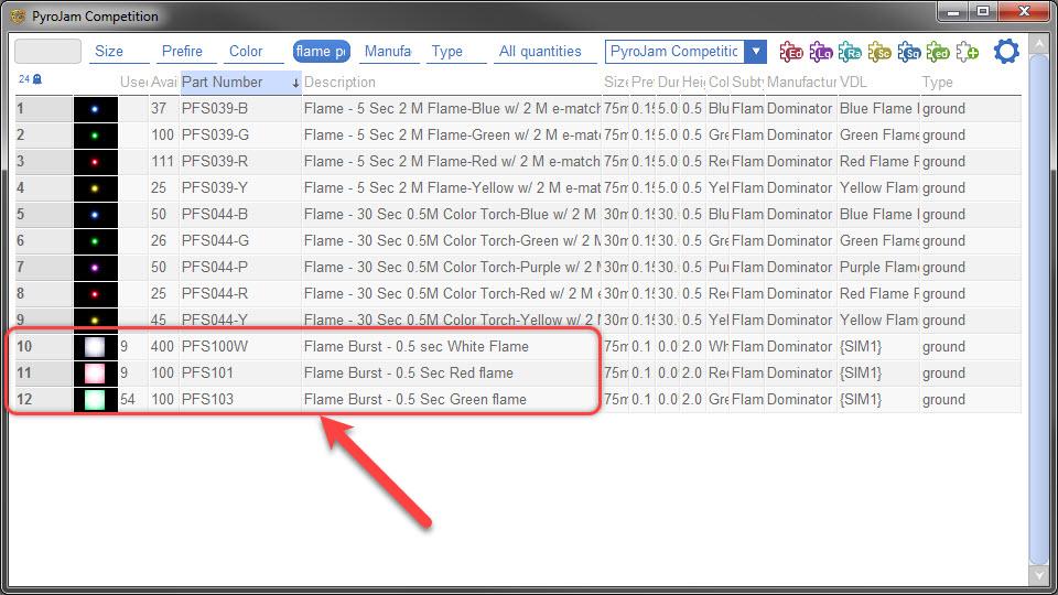

    Hi all. Was wondering if in the Pyrojam catalogue alongside gerbs and fountains, are there any flash pots. The type I am looking for are 1 burst photo flash, ideally coloured.
    Cheers !
    Hi Pyro_5430000, check out the items circled in the screenshot below.
    PyroJam Flash Pots
    Tim Jameson, feel free to jump in here, anything I missed?
    Sean
    Location: Swieqi, Is-Swieqi, Malta
    DrewFinale  Are those really $4.50 a pop ? Wow…
    Hi Sean, I’m not sure about the price. Let me bring in Tim Jameson, his company IPC is producing PyroJam and providing the products so he will be able to confirm the price.
    Tim, can you confirm the price on the flash pots?
    Hello Pyro_5430000, for the purposes of the competition, yes, those items are $4.50 each.  Sorry for the delayed response, but I didn’t have my email notifications checked and yesterday was crazy busy for me.

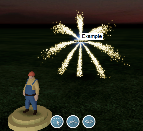

    a lot of my customers are asking if it is allowed to set the front position to a different hight to make use of some special effects like the kind of sun that is the catalog.
    Dirk
    Hi Dirk Enders – PyroOffice, jumping in for Tim here. Slightly elevated firing positions can be used for effects that require it. For example, the “Sun” effect requires a slightly elevated firing position, as shown in the screenshot below. However, elevated firing positions should not be used for other types of effects that can be fired from the ground. For example, elevated firing positions should not be used for comets, mines, strobes, gerbs, flares, etc.

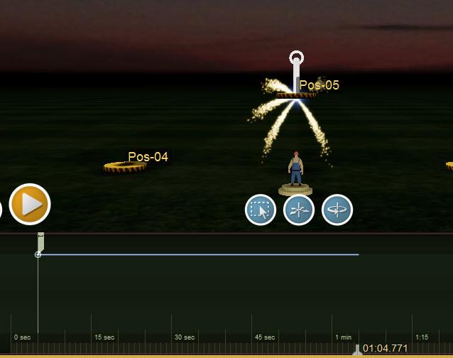

    Then if I want to use a “Sun” effect should I create another line of multiple positions close to the original  “close-prox” group and then elevate them or should I elevate the 19  ground firing positions given?

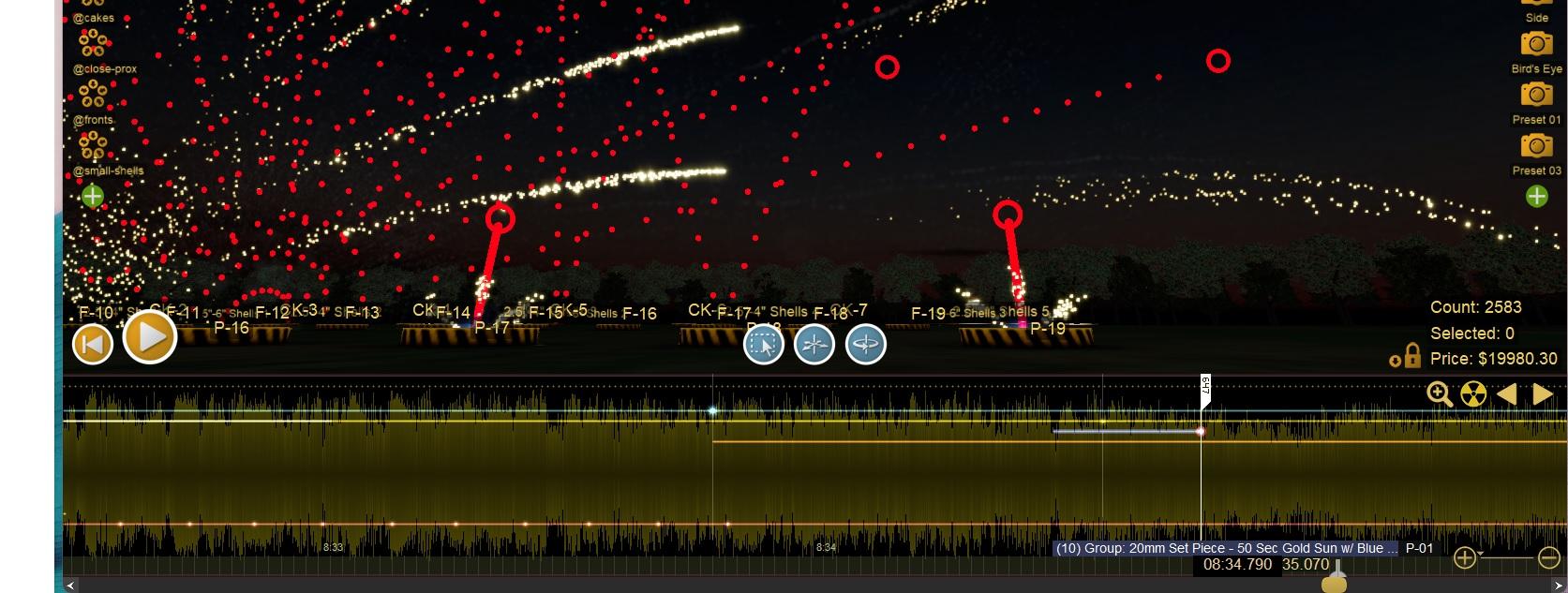

    About the “Sun effect”: it looks like its a 50 sec effect but it  appears on the timeline, when placed, as a very shot effect, less than 1 sec. the line of the effect is super short, not 50 sec.
    Hi Rovira, if you want to use the Sun effect, you can create some additional positions that are slightly elevated. As for the duration of the sun effect, I just added PFS050 “Set Piece – 50 Sec Gold Sun w/ Blue” to the timeline and I can’t reproduce the issue you mentioned. See screenshot below.
    Rovira
    Joined: Oct 2020
    Posts: 12
    Location: barcelona
    This is how short my effect is shown, much less than a second. On the render screen the effect appears for 50 secons anyway.
    sun
    Hi Rovira, this is very strange. Can you go to Help > About Finale 3D… and tell me what “Finale 3D build ID” you are running?
    Rovira
    Joined: Oct 2020
    Posts: 12
    Location: barcelona
    This is what I have:
    “Finale 3D build ID” : 2021.11.17-64adbec3c
