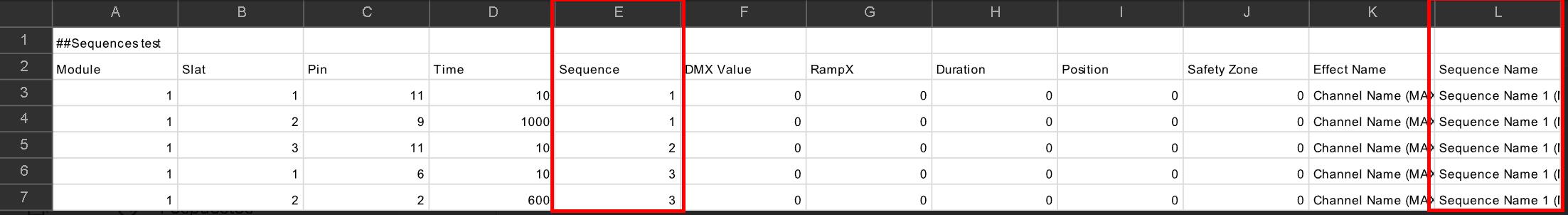

    Excuse me some one know where I can fill the number of the sequence in Finale 3D for FIRETEK Script?… so that when we export the script for FIRETEK this fills the sequence column in the script, also if is possible the sequence name.
    Reference of the sequence column

    The “Track” column in the Finale 3D script window is used to fill both the ‘Sequence’ and ‘Sequence Name’ columns in fireTEK script files. You can unhide the Track column in the script window by going to the blue gear ⚙️ > Hide or unhide a column > Track. fireTEK track values can be integers 0-99 or letters followed by integers in that range (example: “1” and “Trk1” are both okay). For more details, visit the ‘Tracks’ section in Table 2 of our fireTEK documentation.
    Tip: Track numbers can also be set by going to Script (menu) > Tacks > Set track…

    Thank you, that is exactly what I need… you’re the best one
