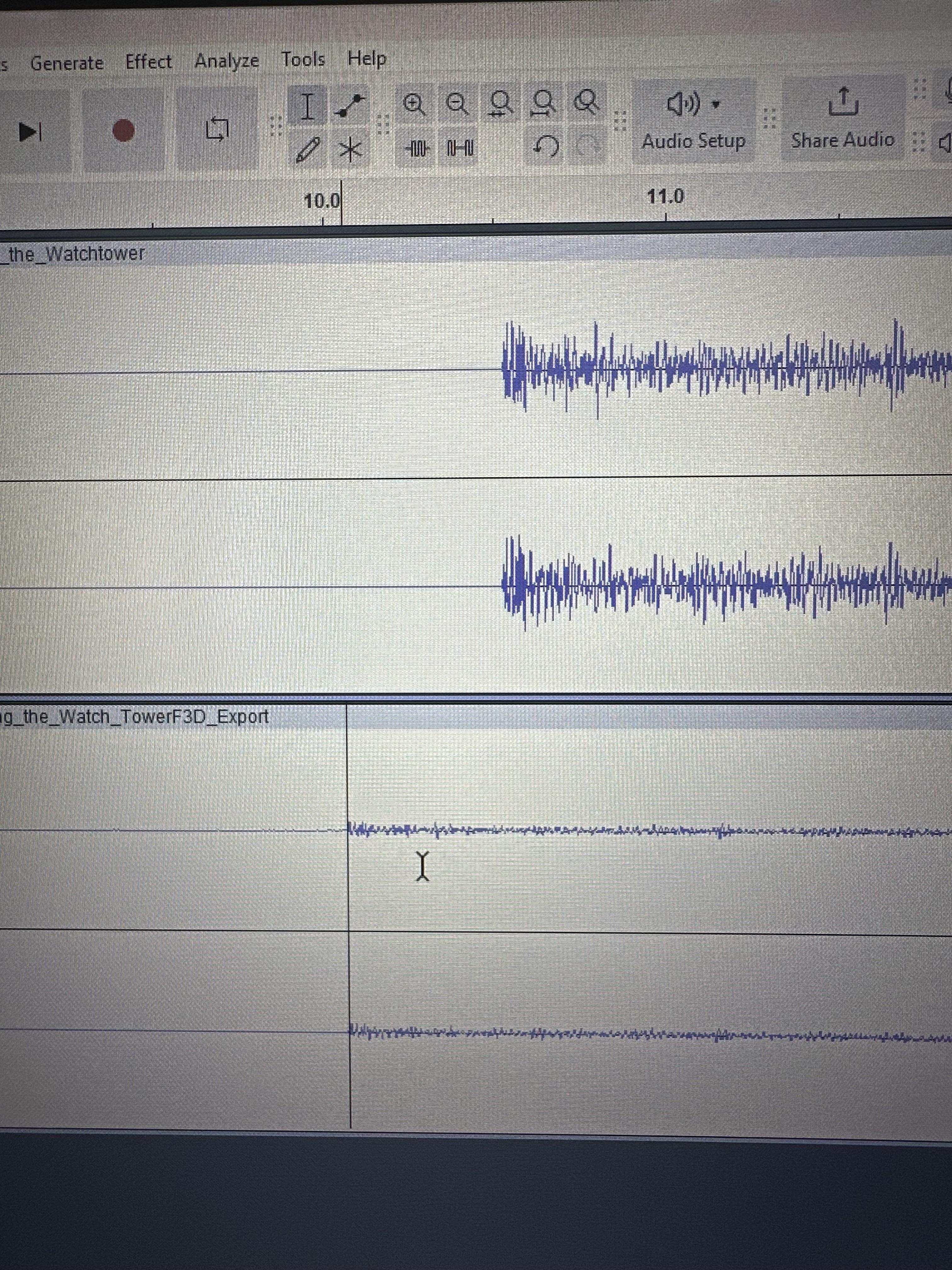

    My show last week, the timing was off by ~.50sec.  When I realigned the music in Adobe premiere, the .50s shift aligned everything perfectly.
    I sent the F3D file to anther experienced designer and he agreed that my scripting should have NOT caused the timing to be off.
    Long and short, the audio file I used for the show wasn’t exported from F3D. I imported the MP3 file, locked it which I must have moved before locking?
    When I exported the audio file last night from F3D and then compared the file I used in the audiobox, there was an ~.50s difference.
    What could have caused the shift if I locked the music file?
    F3D is not an audio tool, so I was skeptical to export it. But going fwd, I want to export it from F3D to be 100% sure it’s correct. But I still have to convert the wav back to mp3 which could introduce an error again.
    -How good is the underlying audio processor in F3D for export?
    -How can I double check the file once I convert it back to mp3? (Probabkly just laod both into a DAW and compare the wav form. Other thoughts?
    -When I exported the wav file to compare the two files, the amplitude (db) was significantly lower than the file I originally loaded into F3D? How do you set db levels in F3D?
    -Will F3D ever be able to export in mp3 format?
    -Top (see below) is what I loaded into the Audiobox
    -Bottom (see below) is exported from F3D — you can see time and amplitude difference – timing difference is .475s
    Import the WAV and MP3 versions of your soundtrack into Audacity. Listen and compare their waveforms side by side at a few points.
    The audio level for an exported soundtrack is based on the per-song Volume field in the songs window and global Song audio volume setting in File > Render settings.
