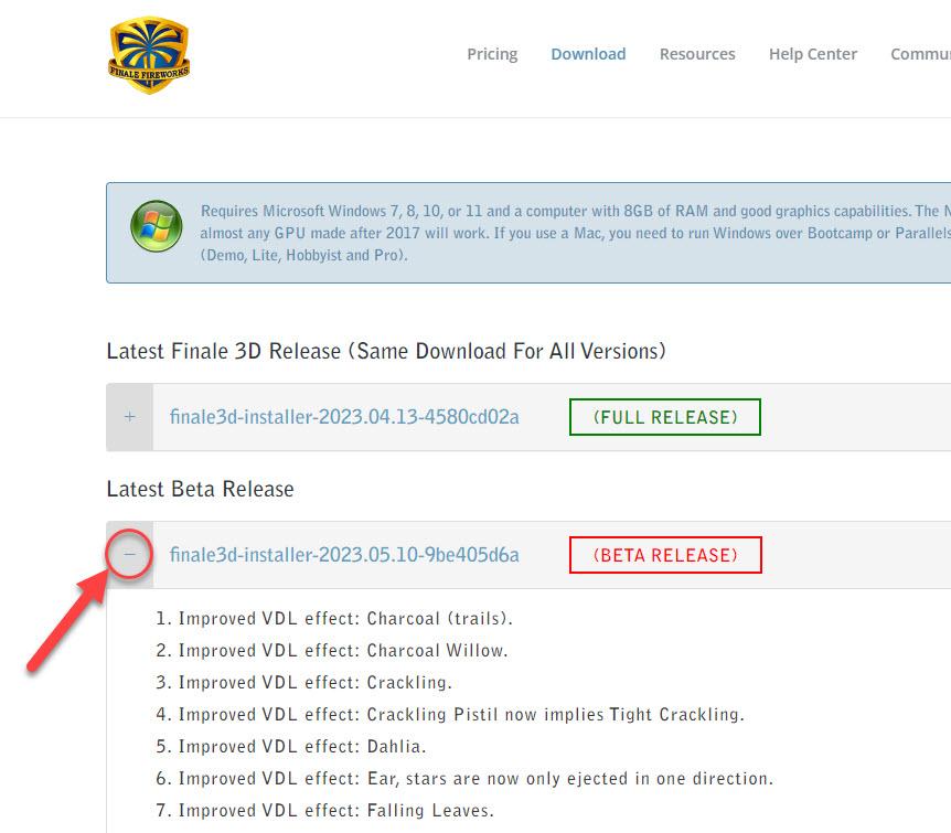

    In VDL terminology, the effect you’re looking for is called “Red Strobing Willow”. More specifically, a Red Strobing Willow Comet. There’s just one problem – it doesn’t exist in the latest full release of Finale 3D. But there’s good news! The day before Cobra-Con, we published a new beta release with tons of effect improvements including brand new VDL effects. To get Red Strobing Willow and all the other new effects, head over to the Download page and grab the latest beta release. After installing, try this VDL to make your cake:

    Glad to hear it! If you’re interested in reading the full list of VDL improvements, click the ‘+’ to expand the release notes on the Download page.
