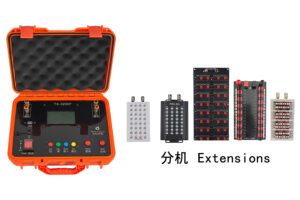

Figure 1 – SBC Spectra Series control panel
