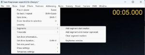

Using Segment Markers to Assign Segments
If you want full control over segment timing or are not using multiple songs, you can define segments using segment markers. Segment start markers define the beginning of each segment. Finale 3D will assign segment numbers automatically for each segment. Alternatively, segment numbers can be assigned manually. Segment numbers can be any integer (starting at 0 by default) and do not need to be consecutive. Each segment defined by a segment start marker must have a unique segment number. A segment continues until the next segment start marker or until the end of the show, unless segment end markers are used.
Steps:
  1. Choose “Show > Segments > Add segment start marker” (a vertical dotted line will appear in the timeline, see Figure 3).
  2. (Optional) Add segment end markers to explicitly define segment end times. If no segment end markers are added, each segment extends to the next segment start marker or the end of the show.
  3. (Optional) Open the Keyframes window (via the Window menu on the main menu bar) to assign a segment number in the Segment column or to delete a marker (see Figure 4). If no number is entered, a default segment number will be assigned automatically at export, starting with 0 for the earliest time keyframe. Finale 3D does not impose limits on segment numbers, but your firing system may — consult your firing system documentation for supported ranges.
