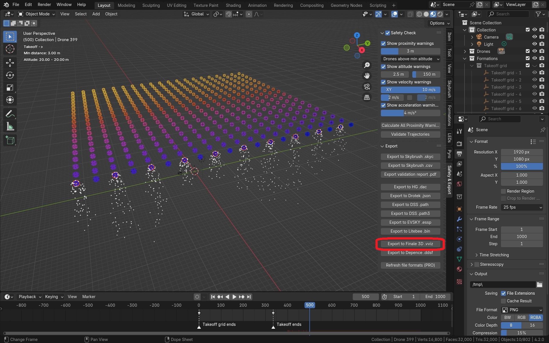

Create your drone show in Skybrush Studio for Blender, including drone motion paths, light animations, yaw control, and pyro triggers. The integrated VVIZ exporter supports exporting all necessary elements to prepare your show for hybrid design or simulation in Finale 3D.
Drone shows created in Skybrush Studio for Blender will have the X+ axis in Blender aligned with the “Front” direction of Finale 3D, and this direction will also correspond to 0 degrees rotation of yaw control in both systems.
Figure 1 – VVIZ export button in Skybrush Studio for Blender

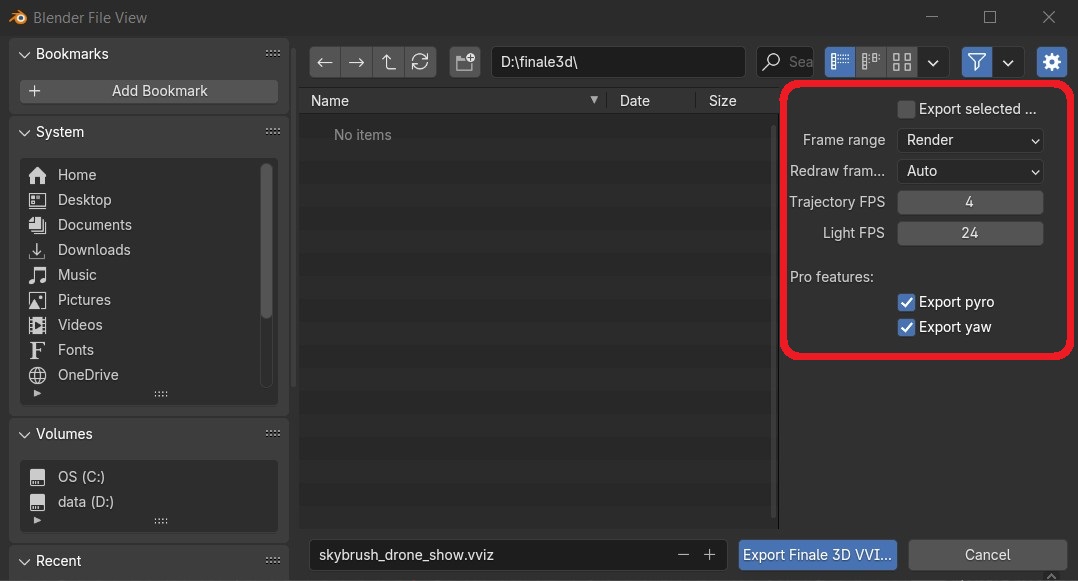

Step 3: Set export parameters
After clicking the VVIZ export button, a dialog will appear allowing you to configure the export options. You can set:
  • Frame range for export
  • Sampling rate (FPS) for trajectories and light animations
  • Time offset
  • Whether to include drone-launched pyro data
  • Whether to include yaw control data
Figure 3 – Export parameter options for VVIZ
