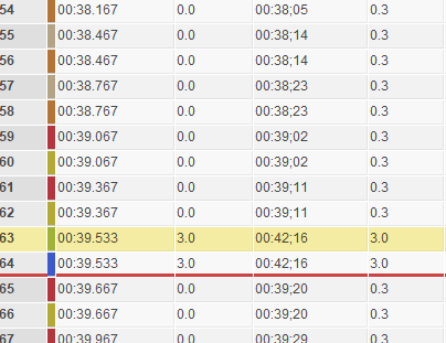

    Hi, I work with a client in fps in this case 30fps and I don’t understand why the column “effect time” is in 30fps but the “event time” is in milliseconds. When a product has “prefire” I have the “effect time” in 30fps but I need to know when the item starts in fps too. Why is it in milliseconds? this confuses me. Is there any way to change this or am I not doing it right. DrewFinale

    I’ve taken this down as a task request (“Add format options for event time in script window.”).  You are right, currently you have options in “Show > Show settings > Set effect time format” but they do not apply to the event time format.  Part of the reason we don’t treat them together is that a number of firing systems including PD use a different time representation for prefire and effect time.  For PD, prefire is in 10ths of a second; for a number of other firing systems, prefire is in 100ths or ms.  Consequently the event times, which are effect times minus prefire times, often aren’t themselves representable cleanly as frames, because they don’t fall on an even frame boundary.  Our formatting options do include the ability to represent fractional frames with millisecond remainders but they are ugly when printed (example: 00:05;11+14).
    So the long winded explanation for why event times are in milliseconds is that I didn’t think people would like the frames representation of them, which would usually have ugly millisecond remainders.
    But it is possible to add this feature, so I’ve added it to our feature request list.

    I often got cuelists which i have to import as a marker into finale 3d. So for me it would be great to have during the import Dialog “do it your self CSV” a possible to say that the time which i want to import have a special format and that finale
    For the script window i prefer the variant as it is at the moment but i think a generated column which shows the show time format  with the ugly millisecond remainders would be a good addition to have acces to it in the script window and reports.

    Hi, when this cuestion is posible to fix? I am making new proyects for 2023 and the new updates not inlude thi fix.

    Hello, regarding the need for displaying the event time in frames, I don’t have a schedule estimate yet.  We are in the middle of a large project right now for improving reports and diagrams.  This project will extend into Q2 of next year.  The project candidate that is likely to be next is adding a whole lot of new functionality around SMPTE.  There is some possibility that this frames request could fold into the SMPTE project; and if that happens then the frames representation fixes may come in late Q2 next year.
