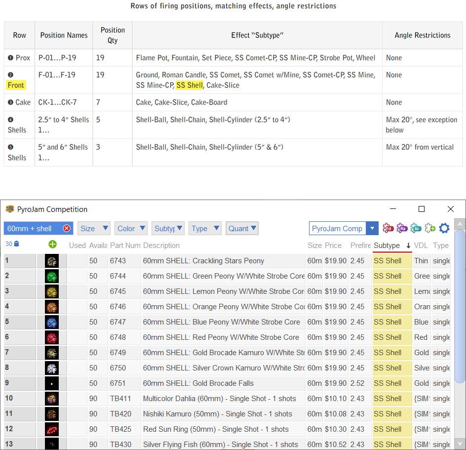

    So if I am correct – 60mm shells will be fired from singleshot positions, correct? As they do not reach the 2.5″ caliber
    Welcome to the Finale 3D forum!
    Yes, the 60mm shells can be fired from the “Front” positions (F-01…F-19). Whenever there is doubt, the effect “Subtype” is the best way to tell which position an effect can be fired from. As you can see in the screenshot below, the Subtype for the 60mm shells is “SS Shell”. By referencing the position layout chart on the competition page, you can see that this Subtype can be fired from “Front” row of positions.

    Quick Clarification: Flame Bursts/air bursts and Gerbs Positions row P or F (1st or second row?) Also, Ground Salutes: I’m assuming they are 2nd row?
    Whenever you have any doubt about which position to use for an effect, just look at the “Subtype” column for the effect in the PyroJam catalog, then refer to the position layout chart on the competition page.
    As an example, take a look at the screenshot below – the Subtype for the ground salute is “Ground”, which goes into Row ➋, “Front” (positions F-01…F-19).
