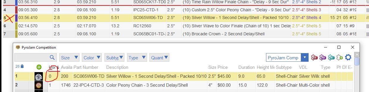

    So while auditing product positions I came across this and wondering if this isn’t counted in my total cost.
    It shows the product in my script and shoots it in the design window but USED shows 0.
    Engineer Cat
    Posts: 35
    Location: New Jersey, United States
    I think I answered my own question. I deleted the effect from the script and my price dropped by the amount the effect cost.. Not sure why its showing 0 though. I do have the two chain options check marked in the user settings.
    Here’s the answer from a bit earlier in this thread: https://finale3d.com/groups/english/forum/topic/pyrojam-2023-official-discussion-topic/page/2/#post-1455338
    You mentioned the chain settings -those are unrelated to the set piece and wheel “macros”. But it might be worth mentioning that both chain settings shouldn’t be “checked”. See: https://finale3d.com/contests/pyrojam-2023/#show-budget

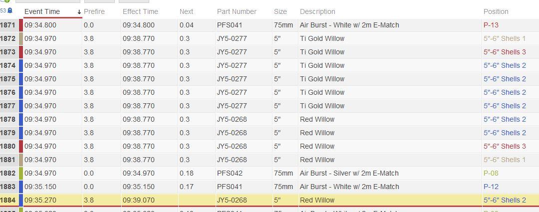

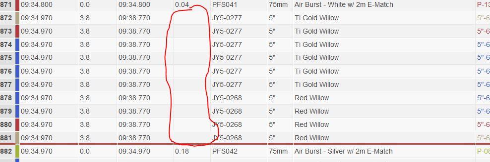

    I’ve run into another issue that I don’t understand. In the script it shows nothing in the NEXT space. So if I delete it, it removes more times from the NEXT space. Why is this?
    Then this happens.
    Hi Engineer Cat, the ‘Next’ column displays the time from any script line’s Effect Time of the next script line’s Effect Time. If Next is blank, it means that nothing else is next. If you delete lines of script, you’ll change what comes next and the values will change accordingly. Your screenshots show that your script is sorted by Event Time. Since the Next vales are based on Effect Time, try sorting your script by Effect Time and I think you’ll find the values will make more sense. Moreover, unless there is a specific reason you need the next column, you can just disregard it or hide the column altogether. The column exists simply because users asked for a column that tells how long before the “next” thing is going to happen in a show.

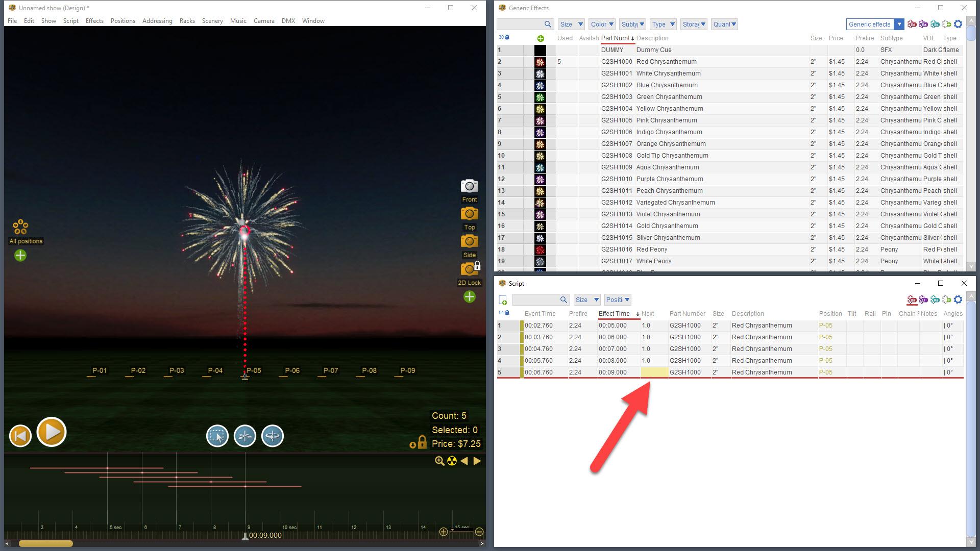

    Thanks Drew. So just to confirm. If the next time is blank that cue will still fire?
    I was worried that there was a problem with the script. That was the only reason I was trying to remove and then replace it to see if the NEXT event time would return. I’m removing that column. lol
    By the way. I came across this when auditing the show. Thank so much for the information on sorting the show to find cues in the wrong positions. I had quite a few I came across but because of the sorting explanation you provide, was able to make quick work of the audit.
    Hi Engineer Cat, take a look at the screenshot below. This is a simple show with 5 shells bursting 1 second apart. The first shell bursts at 5 seconds and the last shell bursts at 9 seconds. The ‘Next’ value is 1.0s for each shell except for the last shell. The 1.0s value comes from the time from one shell’s Effect time to the next shell’s Effect Time. The last shell has no Next value because it’s the last thing in the show, there’s nothing next! No matter the show, something is always last, and the last item will have a blank Next value. Will the item be included in the exported firing system script? Yes, absolutely! Otherwise, we’d be getting a lot of negative feedback.
