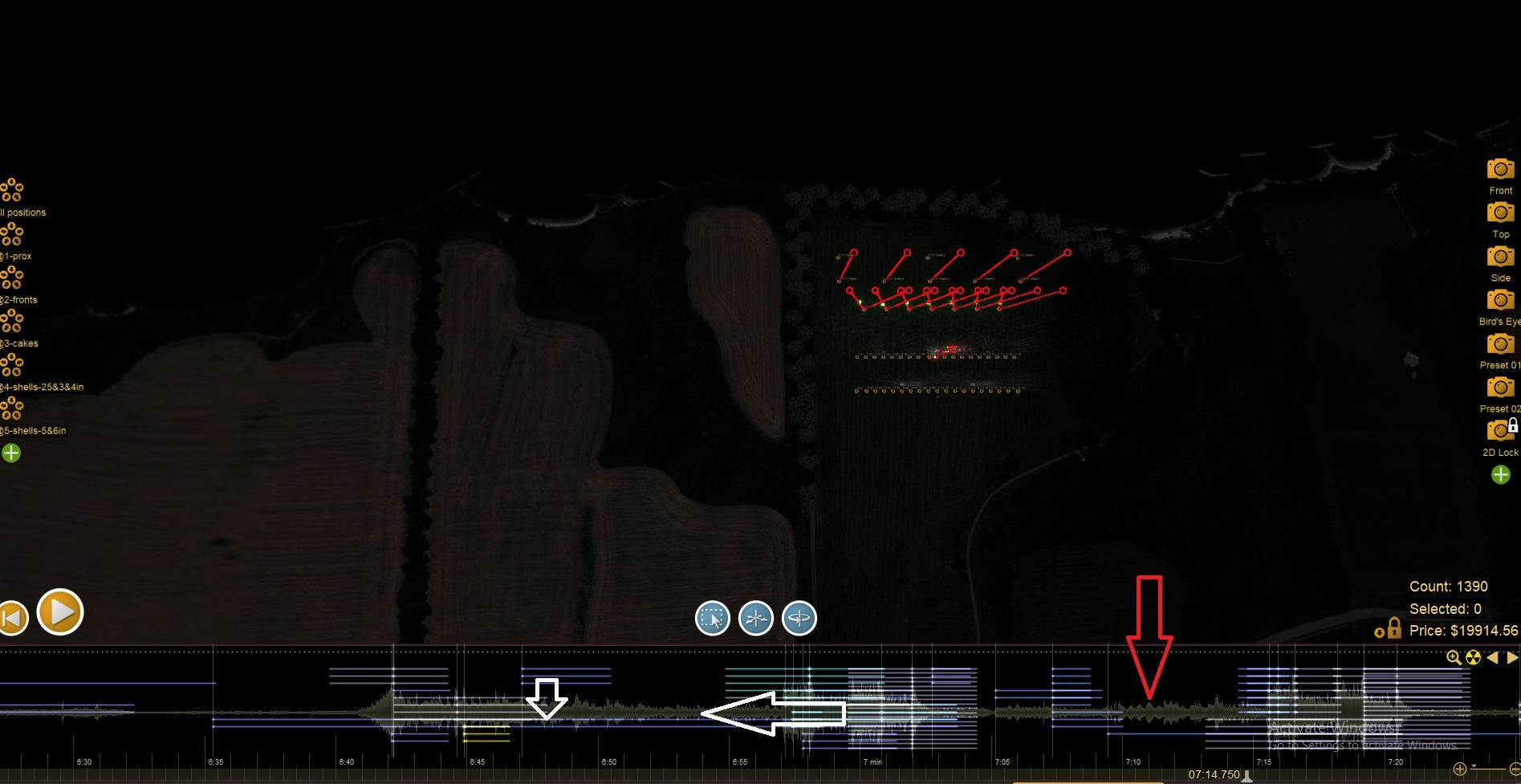

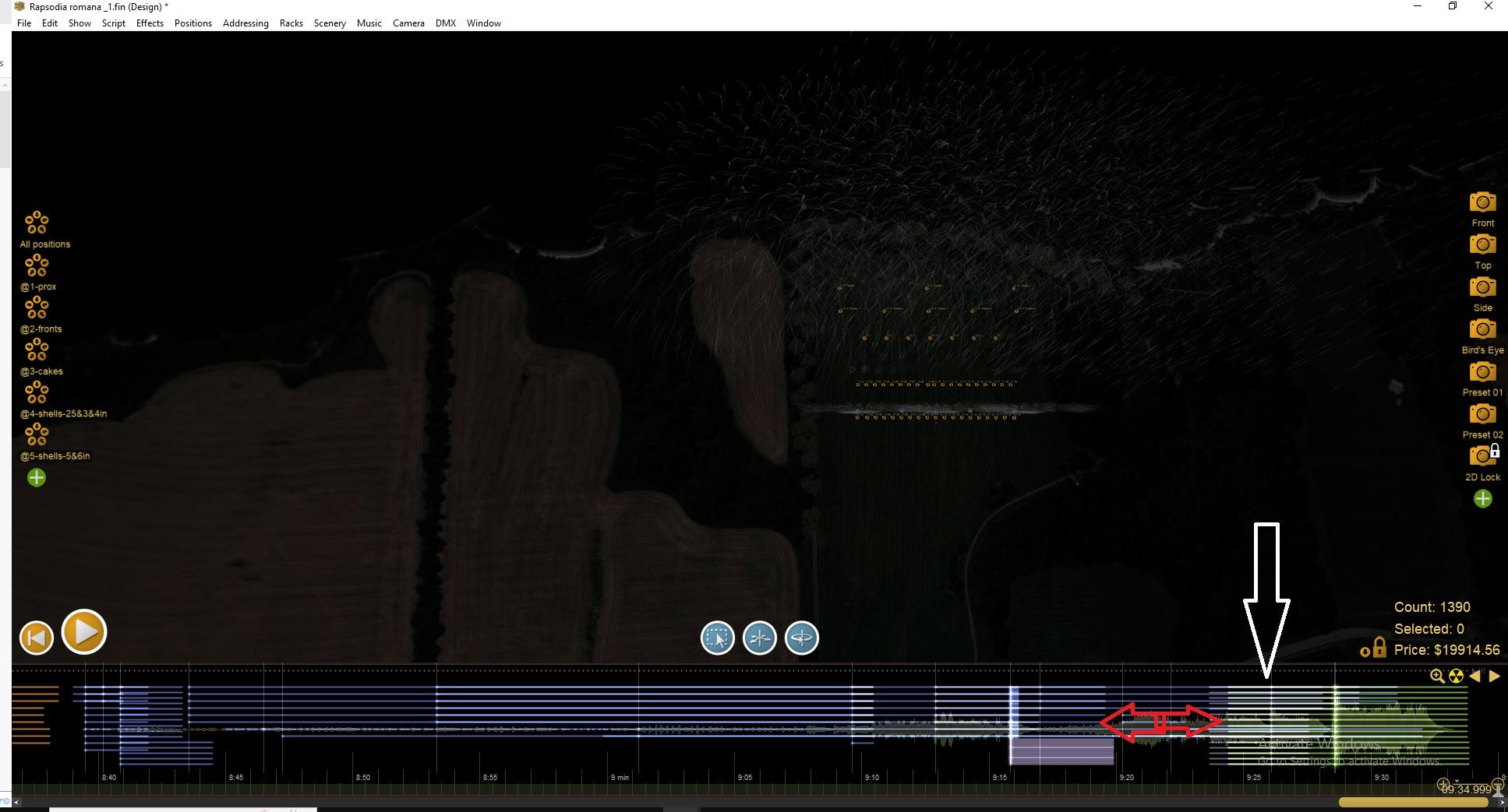

    Marius Colita
    Location: Craiova
    Thanks a lot for the answers and especially for the video! Now I want to ask:
    1. where is the timeline, can it be enlarged, made bigger, wider? Possibly to reduce where the script is visible?
    2. How could I see the music again, if I put a lot of products, effects over it (examples in the images below)
    Tineline 2
    Marius Colita
    Location: Craiova
    3. Can I edit the music mark before on the timeline where to put/synchronize the effect? Mark the Bit? If the effects are still masking my music?
    You can zoom in and out on the timeline using your mouse wheel, or the zoom function on your computer’s touchpad. You can also zoom in and out using the ‘+’ and ‘-‘ buttons in the lower right corner of the timeline. Currently, the timeline has a fixed height and can’t be increased. You can hide and unhide items in the simulation and on the timeline using the search box and drop-down filter lists in the Script window. For example, if you search for “blue” in the Script window, the script, simulation and timeline will hide everything that doesn’t include “blue”. Filtering the script can make it easier to work on complex segments of a show.
    To make the timeline easier to see, you can hide the colorful duration bars by clicking the button that looks like an x-ray/radioactive symbol.
    You can insert an effect anywhere on the timeline regardless of how many other effects are already on the timeline. You can insert an empty cue at any point on the timeline by going to ‘Script > Insert empty cue’, or by playing the show and tapping the ‘i’ key on your keyboard.
