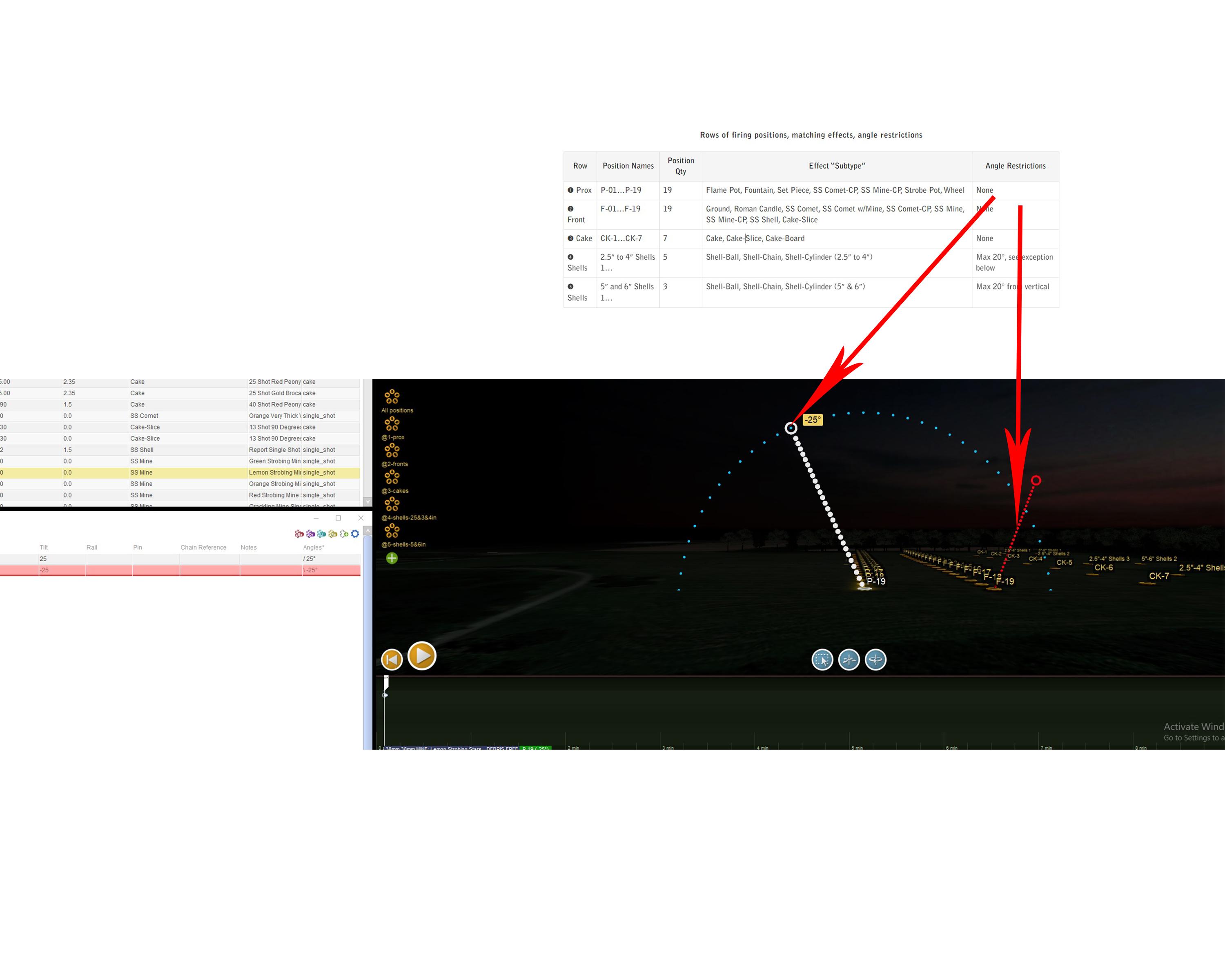

    brad
    Angles clarification.  PROX and FRONT say no angle restrictions, but that only certain items can be shot horizontally.
    For all other items, Is anything less than 90 degrees “not horizontal,” or is there a generally accepted max angle (e.g: 60, 80) we need to stick to?
    – Brad
    – Brad
    Yes, that’s correct, only certain items can be shot horizontally, and the items that qualify for horizontal shooting go on the Prox positions. For everything else fired from the Prox or Front positions, no angle restrictions mean you can fire at any angle less than 90 degrees from vertical. In theory, that means you could fire an item at 89 degrees, but since the non-horizontal items will be fired from ground level, it may not make sense to use such an aggressive angle. The spirit of the rules is to try to give you a much creative freedom as possible, that’s the reason no hard limit is set.

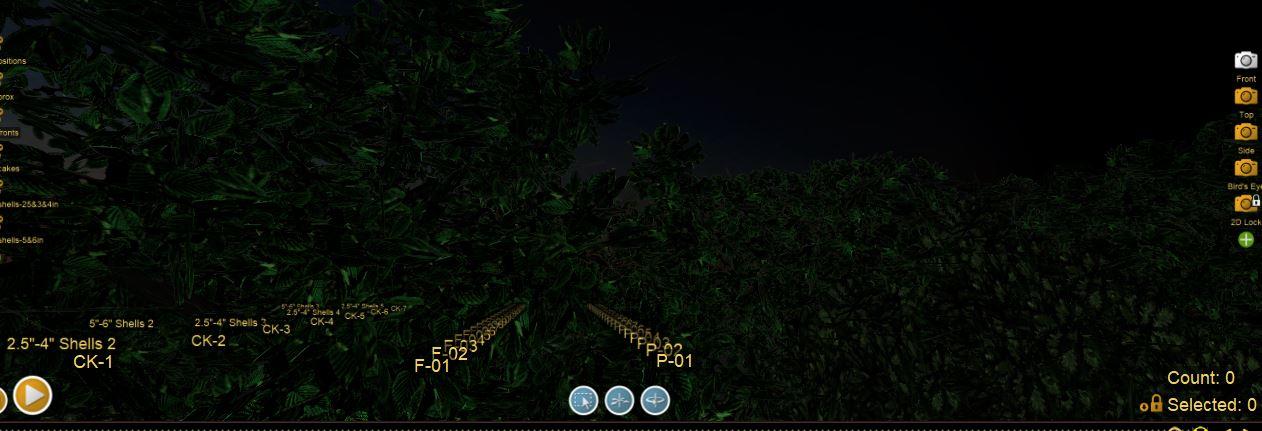

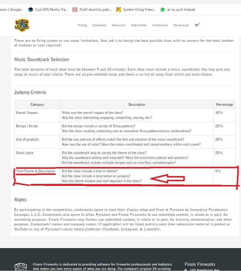

    Marius Colita
    Location: Craiova
    Hello! Excuse the confusion…I hesitate to ask the question, I’ve been putting it off for a long time regarding “Title/Theme & Description”: What we need to know, we’re doing an “essay” like in school. story…what did the author of the song mean or us or…and the author/composer and us…?
    Hi Marius, you absolutely do not need to write an essay. You also do not need to write about individual songs. You don’t even need to write in English, you can write in whatever language you are most comfortable writing. Your show simply needs to have a theme and a title, and when you submit your show, you just need to provide a short description explaining your theme. When the judges review your show, 5% of your score will be based on your theme and how well it is represented by your fireworks design.
    Here are the exact requirements from the competition page:
    Show Title & Description
    Pick a theme for your show. The theme can be anything you like. When you submit your show, you will be asked to provide a show title and a description of your theme. There is no specific length requirement for the show description, it should simply be of sufficient length to introduce your show to the judges and the audience. For example, a show description could be a few sentences.

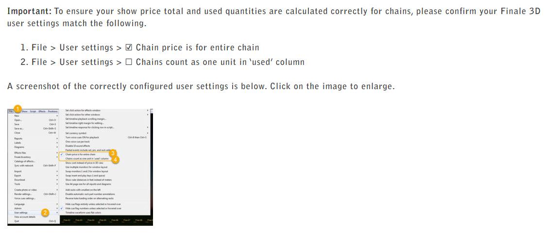

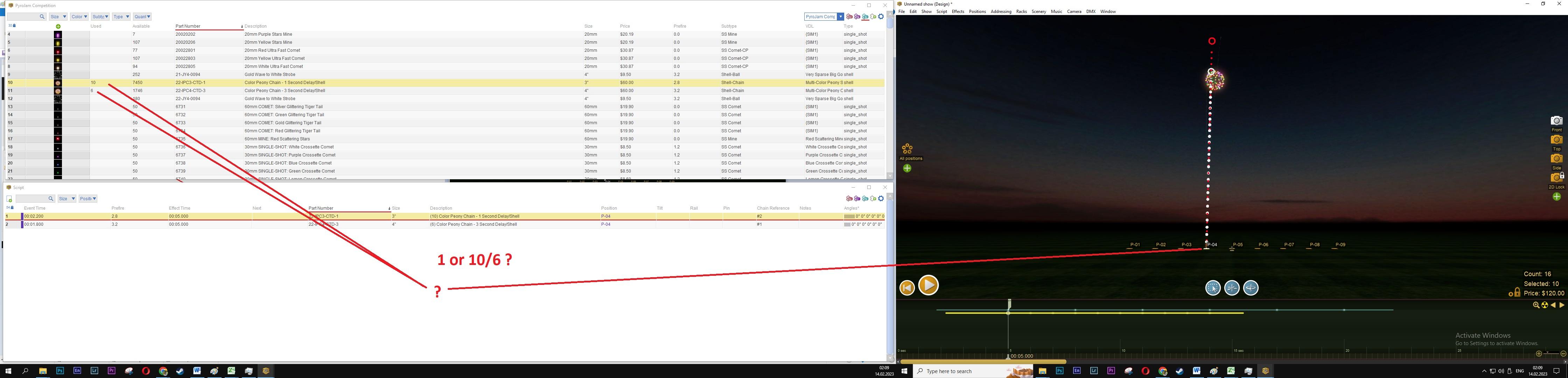

    Now I come with other questions, I think it has already been answered, but I want to be sure! 1. Can I tilt the products used from the “P” or “F” positions in any direction? Including towards the direction of the public? (SS Mine, SS comet even SS Shell or Cake) and 2. Here, when I want to put a single one in the table, it shows me 6 or 10 pieces, how many are actually used? Does the software count the number of “shots”, firings or how many “batteries” are used(photo 1)?
    Hi Marius Colita, great questions, and thank you for the screenshots, they are very helpful.
    1. For safety and other production considerations, effects can only be angled left or right, not toward or away from the public audience.
    2. The effects in your screenshot are pre-made chains of shells. These are shells that are connected together by the manufacturer on a single fuse. Finale 3D can count each chain as 1, or it can count based on the number of shells on the chain. The PyroJam inventory quantities are based on the total number of individual shells available, therefore Finale 3D should be configured to count the number of shells. For example, when you add 1 chain of 10 shells to your show, the ‘Used’ quantity in the Effects window should say 10. Your screenshot shows that your settings are configured correctly. The chain settings are described on the PyroJam competition page in the ‘Show Budget’ section, here’s a screenshot from the page:
