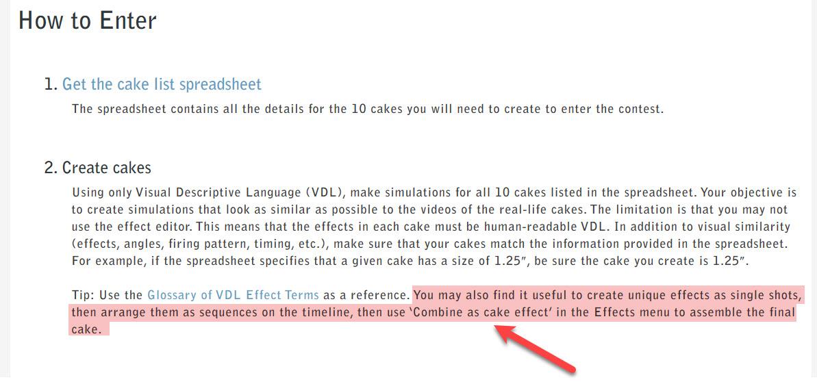

    Are we allowed to combine effects to make the cake?  The VDL does get lengthy.  Thanks, C
    Good Morning!
    Sorry, I’m not sure what you mean by ‘combine effects’, can you give me an example?
    Pyro_269620000
    Joined: Jul 2023
    Location: Olathe, Kansas, United States
    For example, if you were creating the effects individually to get the desired look, timing, etc. Then highlight/select them all to “combine as cake effect.” under the effects tab. Is that allowed? Thanks
    Yes, in fact, the completed full VDL for each cake is what you need to submit for the contest. VDL for individual effects from within cakes (i.e. individual cake shots) can’t be submitted.

    If we have language like this { (30a86/15a81/0a76/-15a96/-30a6678/-20b100/0b/20b4469/30c100/15c/0c/-15c/-30c4759/-20d100/0d/20d4945/30e100/15e/0e/-15e/-30e5052/-20f100/0f/20f/CAK) } at the end of our VDL, will we be disqualified?
    This is from combining things on a timeline and then using the “Combine as Cake Effect”. Just making sure so I don’t put a lot of work into making realistic sims and it all be for not.
