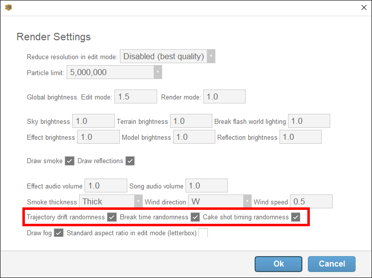

    Hey guys, where is the option to switch between accurate and randomness? I have the same effect at the exact same time on two different positions and they appears to shoot at different times. A little confusing when trying to make everything so accurate. I want keep everything accurate and only look at the real world randomness once completed.

    Engineer Cat , Go to File -> Render settings (or press Ctrl+Shift+J) to change the render settings for those options.
    However, launch times should be reasonably close for effects placed at the same time on the timeline, so if you’re seeing extreme differences, there might be another issue.

    Thanks Neil. I passed over that setting thinking it was only for when rendering to video. Thanks for the quick reply.
    As Neil said, there shouldn’t be any changes in launch times when real world randomness is turned on.  Can you shoot me an email at timj@pyrojamusa.com and let me know which effect/device you’re running across with this?  Thanks.
