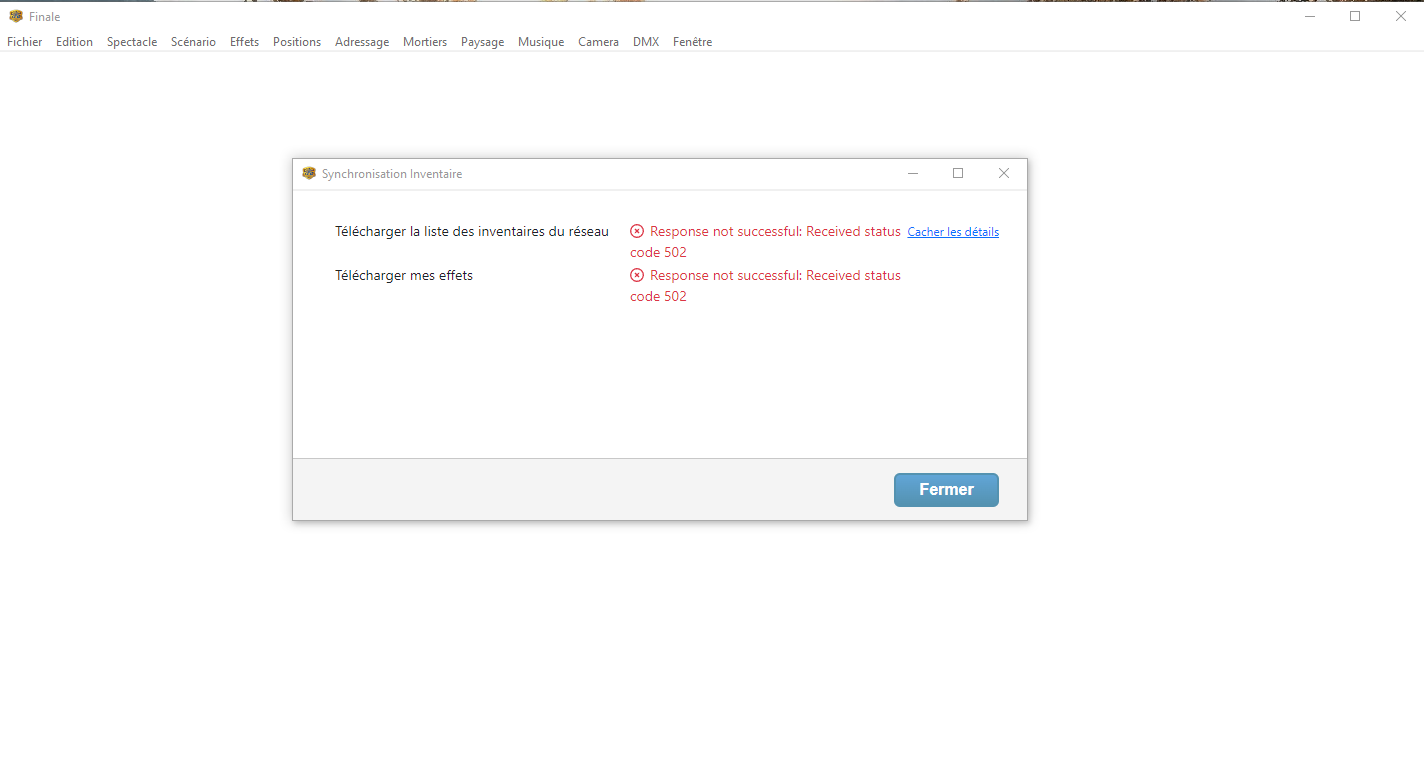

    I’ve another ask concerning an error with software and I don’t know how to resolve that… Could you help me ? Error 502

    I’m sorry for the inconvenience. We are currently experiencing an issue with the sync functionality. We are investigating the issue, and we will get it resolved as quickly as possible. In the meantime, I recommend skipping the sync process at startup by selecting the Login offline option, as shown in the screenshot below. This will allow you to work normally with the exception that you will not be able to make changes to My Effects. However, since you most likely don’t need your My Effects collection to work on your PyroJam show, you should be okay. Any work you do on your show is saved to the show (.fin) file on your computer’s local hard drive. Show files are only saved on your computer, they are not backed up or saved to our servers.

    My apologies again for the inconvenience. I am happy to report that the issue is now resolved. If you try again, you should now find that the sync process works normally. If you have Finale 3D running, you can sync by going to File > Sync with network. Alternatively, if you have the software closed, you can simply launch Finale 3D and login to trigger the sync process.

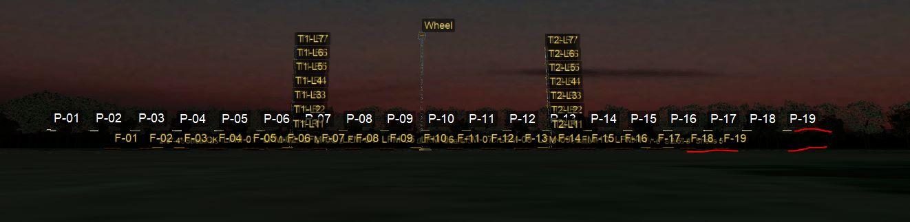

    Bonjour, je viens de voir que ma ligne des position P-01à P-19 ne sont pas au sol. c’est normal ou pas ?
    Posts: 809
    Yes, this is normal. Please see: https://finale3d.com/groups/english/forum/topic/official-pyrojam-2025-discussion-topic/page/2/#post-2538370

    merci beaucoup, donc je peux continuer ma créa.
