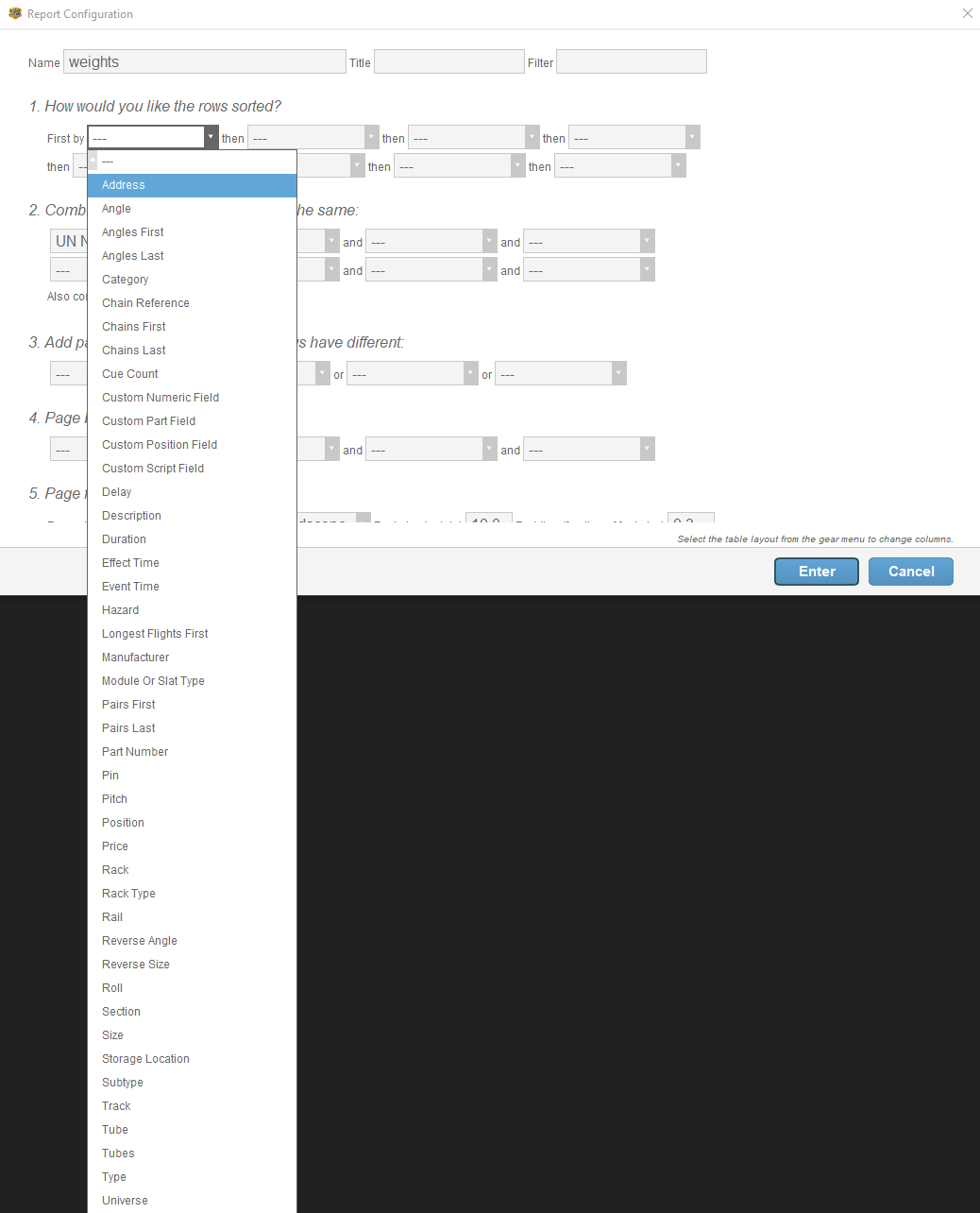

    Missing columns in sorting dropdown of report configuration. Please add them asap.
    NEQ, Weigh, UnNumber, Ce Number, Ex Number are missing here(maybe some others also):

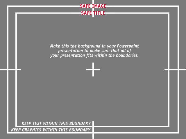

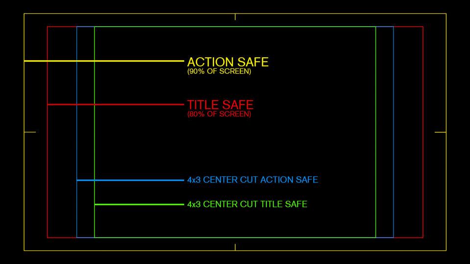

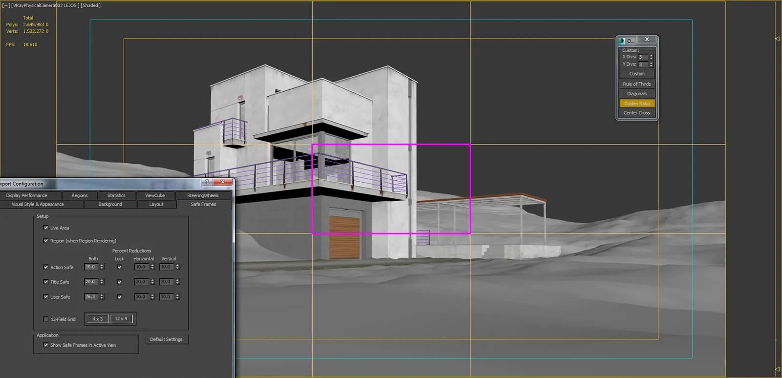

    As such, my feature request is to include compositional guides on any given 3D camera view … including “safe frames, “thirds guides”, and “center guides”. These guides are very common in 3D programs where the final output is on a screen (TV, computer, mobile device, digital billboard, etc.)
    Below is an example of safe frames … though only the “action safe” and “title safe” are relevant. Also notice how the action safe box (yellow) has little center markings for composing elements of the scene. The safe frames where more relevant in composing video for screens in the CRT days, when overscan was a much bigger issue. With modern screens the issue is much less pronounced, because screens are built to specific pixel dimensions, though some TVs still scale the image slightly and some screens have thicker plastic bezels that partially cover the edges of the screen itself.
    The image below shows both safe frames and a “thirds grid” … the thirds grid is most helpful when framing up fireworks videos, because it always looks best on video (especially demo videos) when aerial effects break on the line between the top and middle third …
    This image shows safe frames and a center marker … the center marker is especially useful when trying to center anything within the frame.
    At present, Finale 3D can restrict the preview render to a 16:9 ratio … however this only helps to see the boundaries of what will be rendered. Aligning anything within those boundaries is a real guessing game … and the lack of these compositional guides makes it very difficult to be consistent from product to product, especially when a new project file is created.
