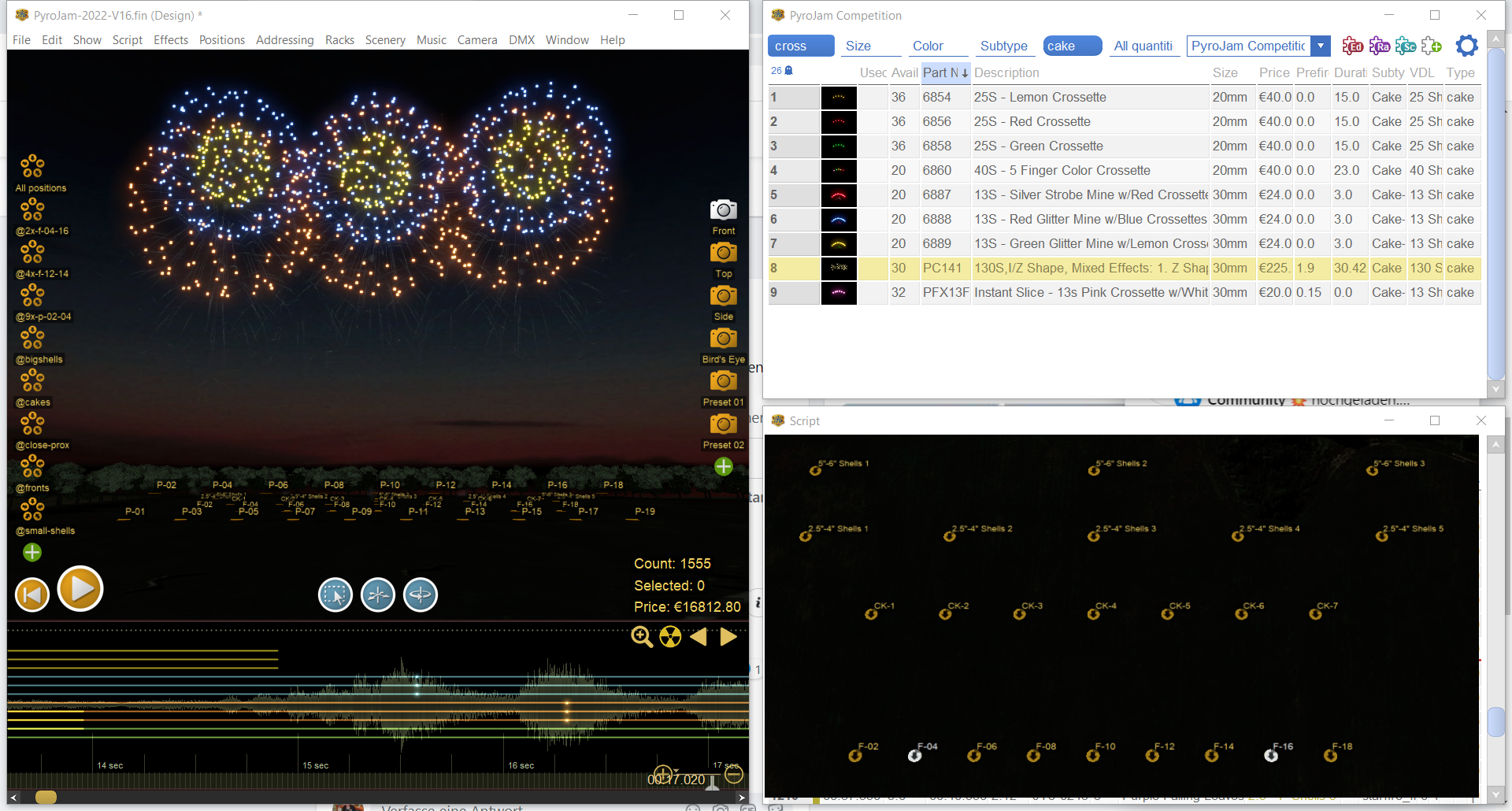

    Hi guys, i am just designing a finale bigger show. A lot of effect in a small time and i have to pick up the positions manually . Building a huge number of groups is not an always an option because it takes space and you have to search. So i have to change to the top view and select the effects , but it is not always easy to find them depending on the zoom level, the displayed effects and the smoke. (see example) To see the effect and adjust the timing i have to change to front view again. This is repeating all the time. I know that i can use the positions window to select effects, but i like to be sure and see the layout. So my idea is to make a seperate screen with the position layout (same as design view from top but without effects) where you can select the positions. The result should look like that What do you think – will this be useful for you, too ? Leave a like if you think so Dirk
    I like this idea. Partially since I have suggested it myself before. I would also like that window to include pos groups. I always select positions from top view. Half of my clicks must be changing between top and front view. Another solution to the same problem, that I think I prefer is a shortcut for selecting part of the selection you just do. (Making up some possible shortcuts that might conflict with current shortcuts but to make the suggestion less abstract) e.g ctrl+number in your example. You select all CK positions. push ctrl 2 and it selects all odf pos. Again, all even. ctrl 3 every third. Etc etc In combination with: if you press tab you scroll through the selection, shift tab scroll back. ctrl tab selects center position, again the 2 pos next to it (moving outwards).
    Is anything happening with these ideas? This would be a spectacular upgrade! This extra positions window (with groups) would be a lifesaver. Excellent idea!
